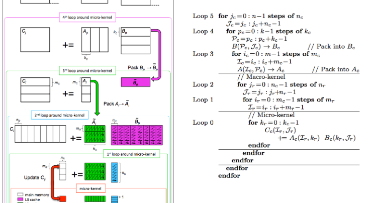

- Principle of Memory Locality.
- The cache is a fast memory access whereby the computer is capable of accessing often required data to perform different operations repeatedly. The cache is used to to reduce the time required by the processor to access local memory such as RAM. In order to exploit the principle of Memory Locality we must know how cache actually works when you are implementing loops and reading data from a array, so if we are able to read the values from the Matrix in a proper way to exploit computer's cache, we are going to increase in the performance of the matrix multiplication Algorithm.
- As the preview image shows, there are 3 loops, c loop , d loop , and k look.
