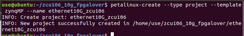

Now let’s create the base project, based on the zynqMP template.
petalinux-create --type project --template zynqMP --name ethernet10G_zcu106
cd ethernet10G_zcu106/

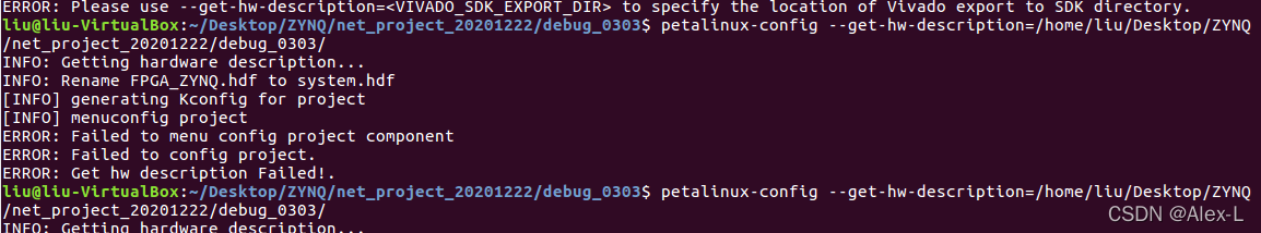

Make sure you maximize your window, otherwise you will get a common error like “Failed to menu config component“(Error_Petalinux)
gnome-terminal --window --maximize

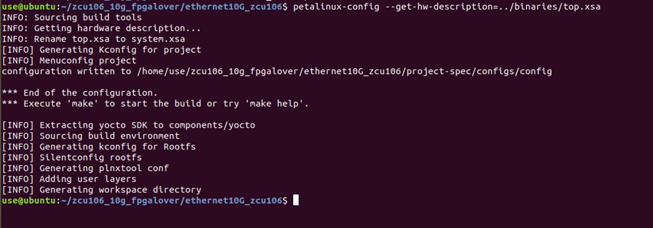

Now, let’s proceed to get our hardware description and adjust our petalinux recipe according to our hardware
petalinux-config --get-hw-description=../binaries/top.xsa

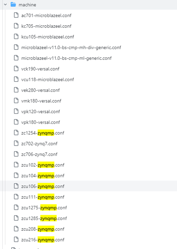

You need to modify the Yocto Machine Name for “zcu106-zynqmp“ as there are many types of boards.
Yocto Settings ---> (zcu106-zynqmp) YOCTO_MACHINE_NAME

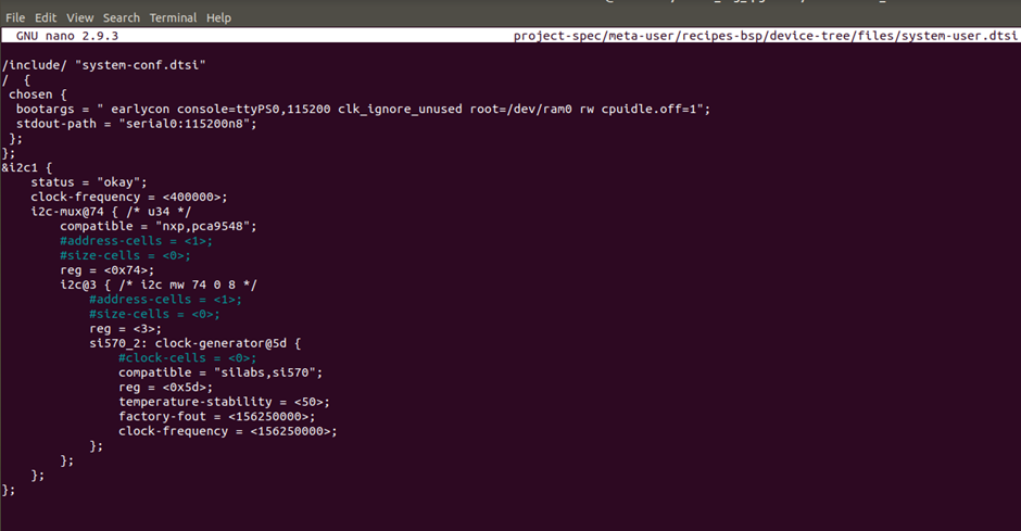

Now we will modify the device tree
nano project-spec/meta-user/recipes-bsp/device-tree/files/system-user.dtsi
/include/ "system-conf.dtsi"
 chosen {
  bootargs = " earlycon console=ttyPS0,115200 clk_ignore_unused root=/dev/ram0 rw cpuidle.off=1";
  stdout-path = "serial0:115200n8";
&i2c1 {
    status = "okay";
    clock-frequency = <400000>;
    i2c-mux@74 { /* u34 */
        compatible = "nxp,pca9548";
        #address-cells = <1>;
        #size-cells = <0>;
        reg = <0x74>;
        i2c@3 { /* i2c mw 74 0 8 */
            #size-cells = <0>;
            reg = <3>;
            si570_2: clock-generator@5d {
                #clock-cells = <0>;
                compatible = "silabs,si570";
                reg = <0x5d>;
                temperature-stability = <50>;
                factory-fout = <156250000>;
                clock-frequency = <156250000>;

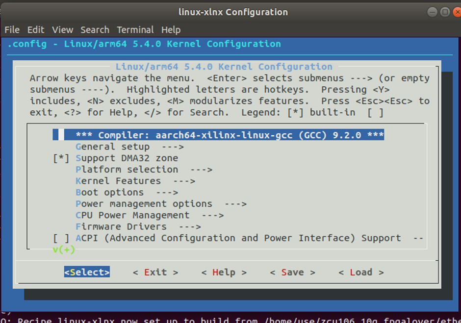

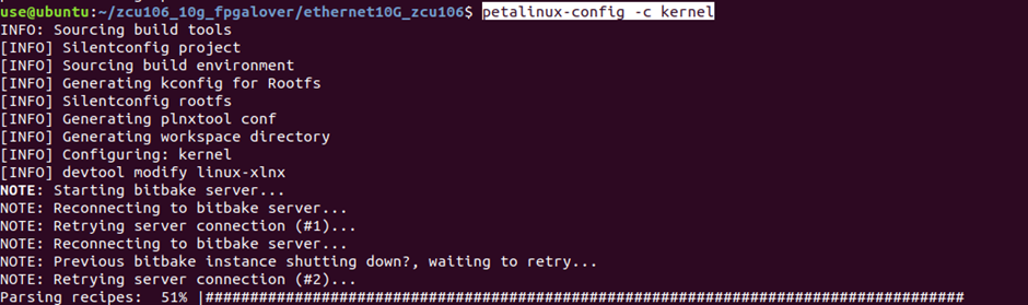

Now you can configure the kernel.
petalinux-config -c kernel

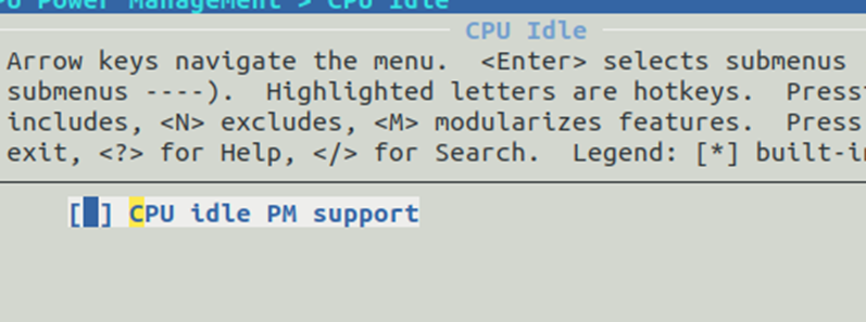

Remove from the configurations the CPU Idle management
CPU Power Management ---> CPU Idle --->[ ] CPU idle PM support
Make sure that you add any driver of feature to the Kernel you might need, exit and save.

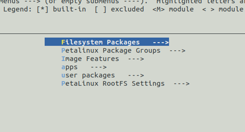

Now, let’s go back to configure the rootfs, with the command:
petalinux-config -c rootfs
Add any package you would like to add to the rootfs, some suggestions would be:

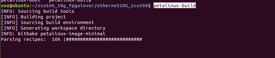

Now we can build petalinux using the following command
petalinux-build

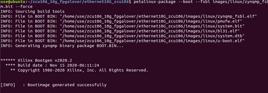

Once built, we need to create the BOOT.BIN file, which contains the bit, the fsbl, the u-boot, and the pmufw.
petalinux-package --boot --fsbl images/linux/zynqmp_fsbl.elf --u-boot images/linux/u-boot.elf --pmufw images/linux/pmufw.elf --fpga images/linux/system.bit --force

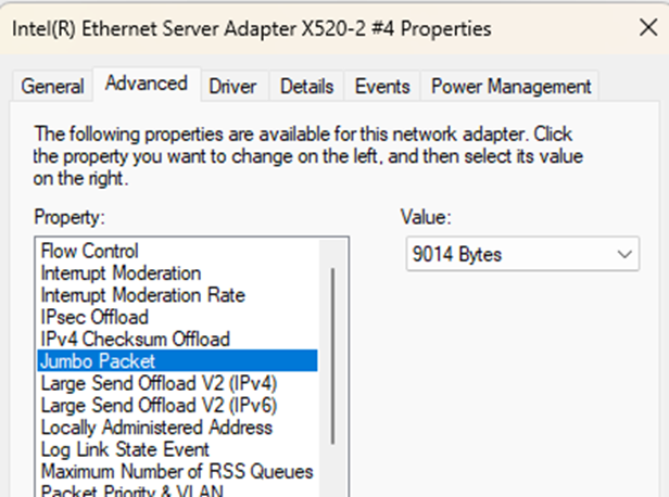

Now we need to also change the MTU for the interface of the target, so if you are using Linux you need to execute the same command on your terminal. However if you are windows, you need to go to “Control Panel\Network and Internet\Network and Sharing Center” and select your 10Gbps network adapter and change the interface to be enabled to received Jumbo Packages.

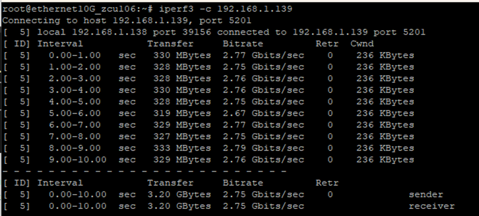

Now on your zcu106, you can run iperf3 as client to connect to the server, for this you need to know the IP of your PC host iperf3 server.
iperf3 -c <ip of you iperf3 server>
You will see depending on your network quality, the load of the ARM, the MTU size and other factors something like this on the zcu106 terminal
and on the server:
