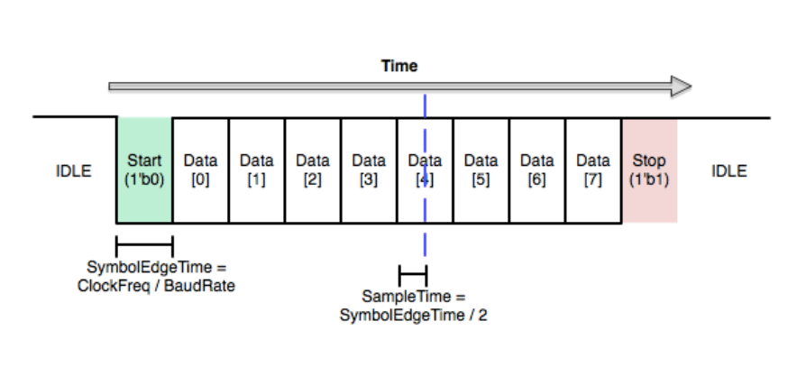

Today, the use of UART serial communication in embedded systems and electronics projects is very common. UART communication is found in Bluetooth devices (SPP), WiFi, Ethernet, USB conversion, audio and video devices, and communication with a wide variety of OEM cards.
UART
Verilog code UART Full Duplex(UART_FullDuplex.v):
change parameter "baud_rate" to change speed rate

//=====================Baud Rate Generation==================
parameter clk_in_freq = 50000000;
parameter baud_rate = 4800;
localparam counter_limit = clk_in_freq/(2*baud_rate);
